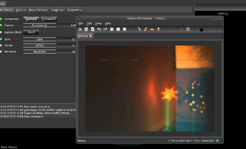

« Відповідь #2550 : 01 Січня 2017, 13:36:41 »
Hi
i've finished building my cam86 board, this is the place to say thank you !
As a gift, here is the first picture taken with brand new driver for linux :
i will soon release the code on my github, for anyone interested on the subject

in fact driver is already online :
https://github.com/gehelem/indi_cam86_ccd
Please note that it is really "beta beta test" and needs lots of improvments (anyway, any help is wellcomed  :) )
@Rim/Sergiy : can you check if the way i talk about your work in "AUTHOR" file is ok for you ?
