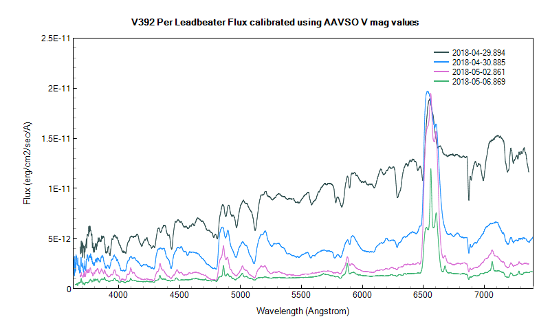

Спектр Новой эволюционирует вот так
Mon, 05/07/2018 - 13:04 (new) #46
Robin Leadbeater
spectrum update
Although still dominating the spectrum, the absolute flux in the H alpha line is now also falling
