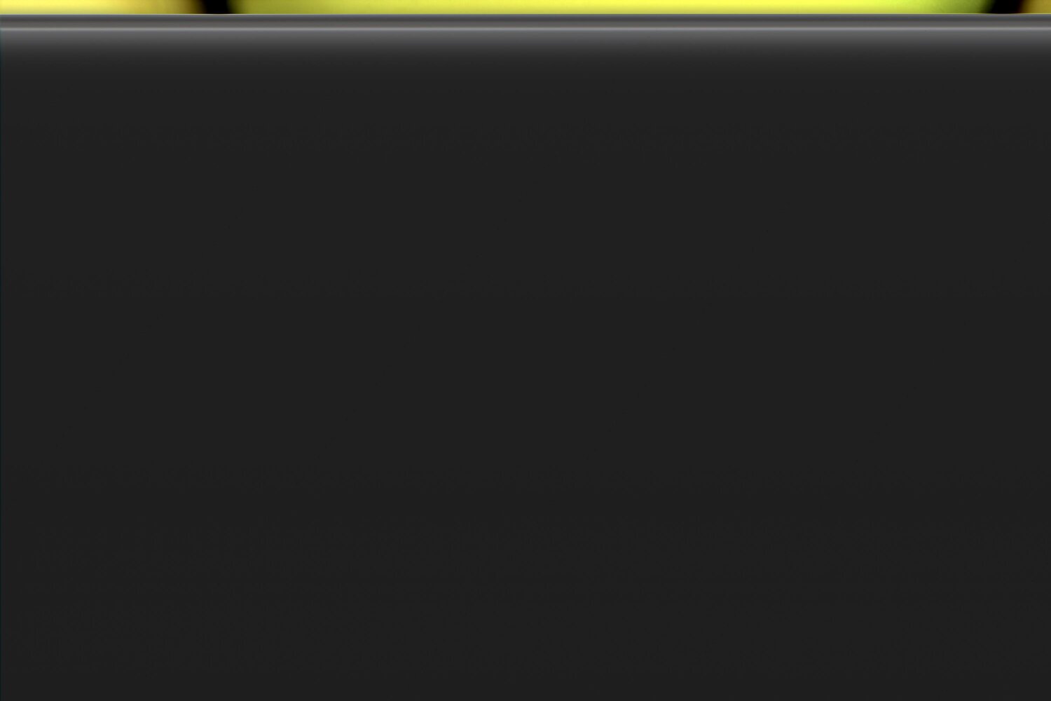

Hello all !
this is my first light with my homebrew cam87
not perfect, but not so bad ! the first 36 lines are read correctly ... but none of the others :/
I don't have time now for more investigate, I'll back on the project on spring.
stay tuned :)

« Відповідь #3539 : 18 Січня 2021, 18:42:22 »
Hi !
it's the square version, "boxed"
the voltages are OK, the power thru USB seems OK (1.2 to 1.6W, didn't fall)
there are somes bugs on the schematic / PCB (SWD port is reversed, the EEPROM has the pin 7 to GND instead of VCC ...) but nothing critical
the strange part is that the top of the sensor seems to be correctly aquired
I quickly plugged an oscilloscope on various pins, H1/H2, V1/V2 ... the signals were weird, nothing but square like expected
but didn't have time to really take serious measures
French DIYer - how far can get pushed a 130P Heritage ?
