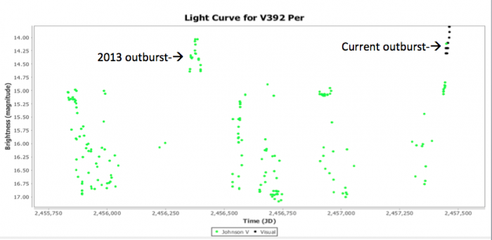

Ну во-первых, по таким поисковым картам ее хрен найдёшь, особенно в полнолуние, как сейчас. А во-вторых, насколько я понял из сообщений с AAVSO, эта звезда уже вспыхивала в 2013г.
Оригинал:
"This is not the first anomalous outburst of this star. In 2013 it went into outburst March 1, reached a maximum of 14.0 on March 24 and was still as bright as 14.6 April 16 when we finally lost it to the Sun. I don't know of any other CV that has prolonged rises to maximum and outbursts that last 6 weeks or more. Perhaps drawing attention to the second known instance of this kind of behavior will finally encourage further investigation, like time series observations to see if it has superhumps."
Источник: https://www.aavso.org/v392
https://www.aavso.org/v392-long-outburst
